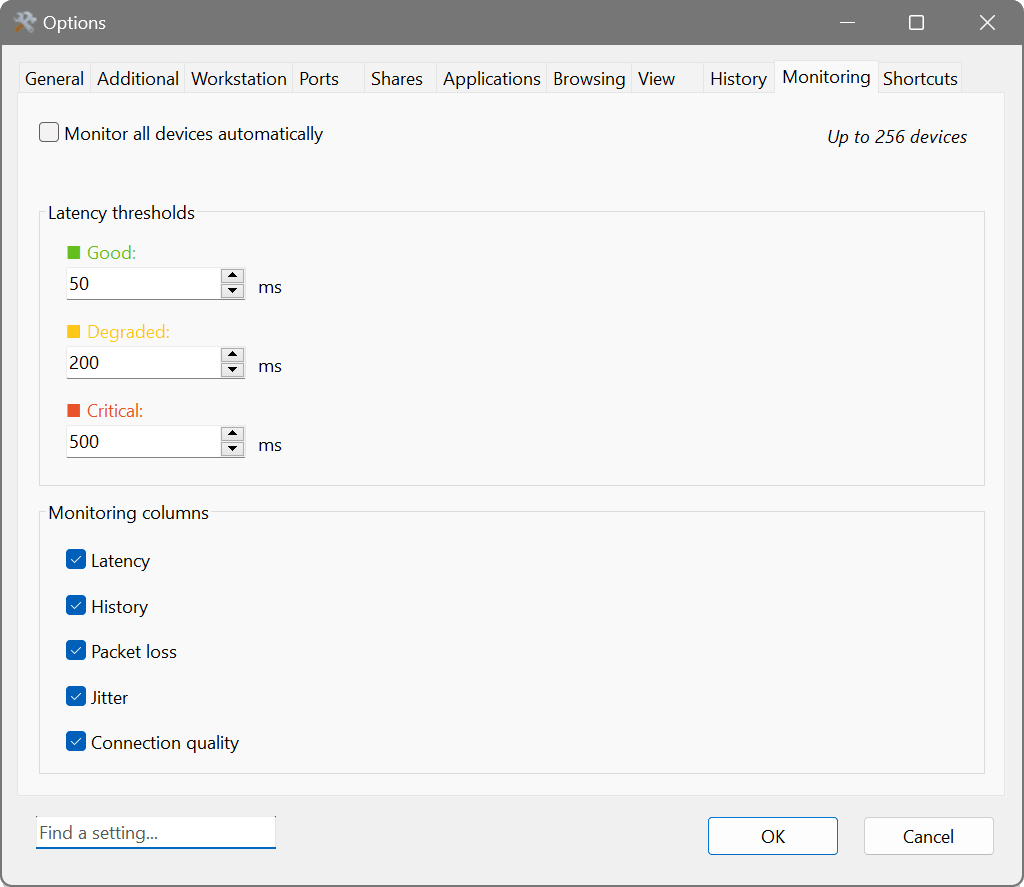

Monitoring
Options - Monitoring tab
The Monitoring tab controls live monitoring. Tick Monitor all devices automatically to monitor every discovered device without selecting them by hand. The Latency thresholds define the boundaries between the Good, Degraded and Critical states used by the traffic-light indicators and charts, and Monitoring columns chooses which columns appear in the results.
